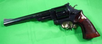

Here is a pic, Thanks again,
Varooom

The finish is bright blue, grooved top.
Definitely 8 3/4 barrel.

More pics.
Too many things don't sound right.
Guess I will keep looking.
Thank you all,
Varooom

If you look closely at the frames topstrap where it meets the barrel rib you will notice the frame shoulders are machined back at an angle.
This was done on frames intended for narrow rib barrels back in the day ( Model 27 and Model 28) ,
Frames that went with wide rib barrels were not.
BTW Today the frames are all just left wide.
28-2 = .357magnum Highway Patrolman w/ 4 or 6 inch barrel and mat finish.
OPs if I read the thread correctly and see bright blue pictures of a .44 magnum........only one answer
FrankenSmith!!!!!
or simply miss-stamped?
Based on the photos and the different style of ampersand on the barrel and frame, I would "guess" the Magnum started out as a Model 28-2 and was converted to 44 Magnum caliber, Model 29-2, by rechambering the cylinder and replacing the original barrel with a 29-2 barrel that is 8 3/8-inch. Also added were target stocks made of Goncalo alves, target hammer, target trigger, red ramp, and probably a white outline rear sight.

Looks like a mix master franken gun. I think the frame is 28-2, barrel and cylinders are 29/44 mag. That price is high for a gun so molested.
I would say the cylinder was replaced, not rechambered. The .357 N frame cylinders were short, this one fills the frame window.
No clue what the real story is, just another observation.

IF WE "BUY THE GUN AND NOT THE STORY" WE WOULD DEVALUE THE NOTION THAT REVOLVERS LIKE THIS WERE ASSEMBLED BY THE FACTORY, DUE TO A SHORTAGE OF REAL M29s.....
IMHO, THIS REVOLVER IS THE CREATION OF A GUNSMITH WHO REBARRELED THE M28-2 FRAME, AND BORED OUT THE CHAMBERS OF THE .357 MAGNUM CYLINDER TO ACCEPT .44 MAGNUM AMMO.....
I WOULD ONLY CONSIDER PURCHASING THIS REVOLVER AS A KNOCK-AROUND FIELD GUN, IF THE ASKING PRICE WAS MUCH LOWER......
