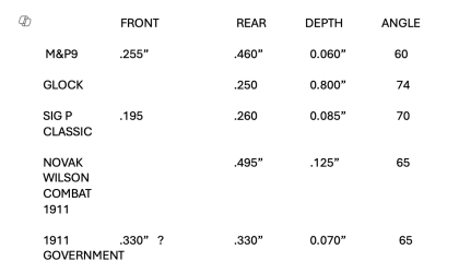

A short compilation of various dovetail angles / widths commonly encountered etc.
Screenshot 2025-08-02 at 7.44.10 PM.pngScreenshot 2025-08-02 at 7.45.20 PM.pngIMG_5165WILSON COMBAT REAR SIGHT DIMENSIONS 01.31.25 copy.jpgScreenshot 2025-08-02 at 7.48.33 PM.png
