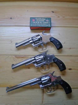

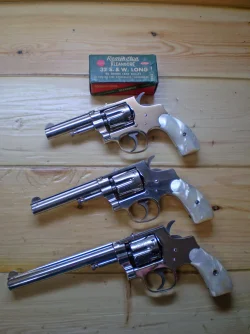

Welcome to the Forum. All triggers and hammers were case colored at the factory. Some have faded over the years while others were inappropriately plated or blued by an owner. Your revolver was likely shipped in 1898 or 1899, but since all frames were made and stamped before 1899 all First Model 32s are antiques, not requiring an FFL to purchase or sell in almost all states. They are fun to shoot and require 32 Long ammo. These guns came in 3 standard barrel lengths, 3 1/4", 4 1/4", and 6". I once had all three in nickel, but all had distributor pearls. Factory pearls of the era left the factory with gold medallion stocks, and I like the black hard rubber best, so replaced all.
