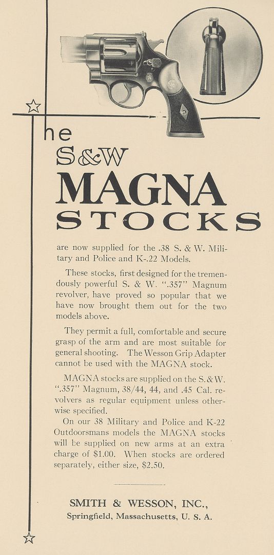

Hopefully the following can be helpful to the Magna discussion.
Here's a copy of the magna insert:
Note the language: "These stocks, first designed for the tremendously powerful S. & W. ".357" Magnum revolver..." - another indication that the magnas were introduced in 1935. :)

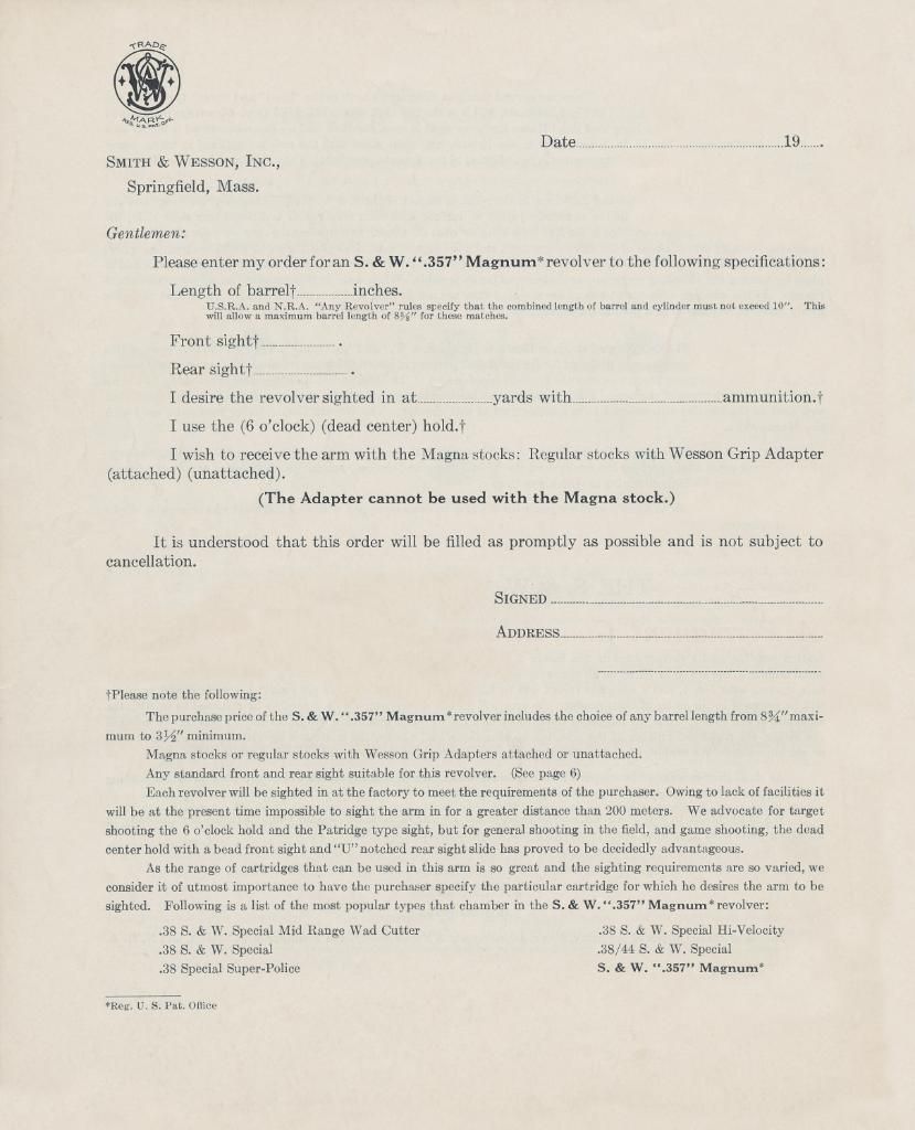

Early 357 Magnum "Brochure/Order Form" - note that magnas were not pictured or listed as an option:
Front:
Back:

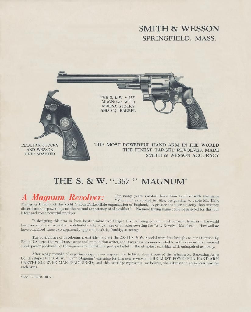

Later (post magna introduction) "Brochure/Order Form" - note that magnas are now pictured and an option:
Front:
Back (note that magnas are now an option):
My December 1935 Magnum letters and invoices as shipping with magnas (and they number to the gun), so by late 1935, Magnums were shipping with magnas.
All evidence that the magna grips were introduced in 1935. :)
