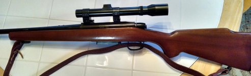

Ever seen one of these !
To the OP, John's Gun & Pawn in Clayton, GA had a couple of Remington 788 rifles in .44 magnum the last time I was in there. Pricey for sure, as the things are scarce.
be careful racking the bolt back too hard. you can break the extractor. it is a frail little piece on the bottom of the bolt. same on the .44 mag. at one time I collected 788s and had them all, even a left handed one in 6mm. I found my 30-30 in the classifieds while stationed in NE. it was listed as a bolt action 30-30, no brand name. I called really early on sunday morning and got there first and snapped it up. enjoy. lee
I have owned 788s in .30-30 and .44 magnum.
Relating what I paid for the .30-30 won't make you happy. I bought it a while ago. I obtained excellent cast bullet 100 yard accuracy with the .30-30 the first day out and it only got better from there. IMO the 788 was the most accurate production .30-30 ever made. Magazine length limits what you can do with spitzer bullets but some shot very well.
At the 1985 NRA annual convention I asked Remington's table staff how many .44 788s they built. Their answer was that it was probably the least produced model/caliber combination in modern times. Mine had shallow grooves with a .430" diameter. It did not shoot cast bullets as accurately as a .44 magnum Ruger #3. It did however readily produce 1 ¼" 5 shot 100 yard groups with jacketed bullets.
Lee Barner is correct that 788s for the two rimmed cartridges are often seen with the extractor/cartridge loading guide protruding from the bottom of bolt faces broken off. That piece was hard to find in the 1980s and finding them has not gotten easier. Jack First made some years ago but I believe they sold them all. A friend broke one trying to chamber a SWC .44 bullet. The shoulder of the SWC caught on the bottom of the chamber. I don't know how else they'd get broken. Be careful.
I'd love to find another 788 in .30-30 that still has an intact extractor. A little time machine would make that a lot easier.
