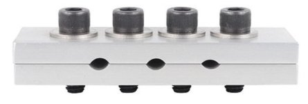

There are lots of ways to manage this, including Vise Grips padded with leather. This is what I use and the major online sellers offer them.

Anyone who owns or has access to a Drill Press need not buy a ER removal tool - the Jacobs Chuck works better! Hint - pull plug out of electrical outlet so the motor does not accidentally engage!

I just drilled a hole of the rod's diameter through a short piece of 3/8" diameter brass rod, then split one side lengthwise using a hacksaw. Slide it over the rod then squeeze and turn with a vise grip. I also lathe-turned two pieces of brass rod to fit snugly in the chambers instead of using empty cases, so no movement of the extractor star is possible. But I have used pliers and leather also.
The last time I wanted to remove an extractor rod, I found this old pair of Giller pliers really handy (with a bit of leather or sheet lead to protect the rod). I picked them up at a secondhand store a couple of years ago. Made in the 60's I think.
