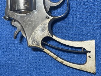

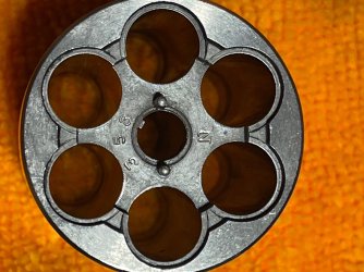

Acquired this one recently. Seller wasn't particularly helpful with pics but I took the chance anyways. I know factory nickel guns have the N stamped on the butt and cylinder face. Not exactly sure this one is. It has an N on the butt but not on the cylinder face, rather under the star and the font is both smaller and different than what Ive seen before in both places. Can anyone confirm this is a factory nickel gun? Also the proud pins on the front sight. I was under the impression the proud pins were something from the 50's. The lazy & and pins make me wonder if the barrel has been swapped. This gun dates to 1965 (K630729) if I am not mistaken. I dont have much into this piece so my feelings wont be hurt either way but I am wondering what exactly I am dealing with besides a nasty, uncared for model 19 that in need of some lovin'. That I can and will provide.

I have a nickel 29 no dash from early 60s which has the small N under the extractor star, like your 19, rather than the cylinder face. I believe that's the way it was done at the time.
I can't speak about the pins without it in front of me. I can check tomorrow
From the pics posted, it looks like a factory nickel.
That ampersand is quite common on Model 19's in the K623 ~ K654 range.
Since the front sight is blued and the barrel is nickel, the proud pins are quite common. Usually the front sight would be installed on the barrel, the pins polished flush and then finished. That's not possible in this situation.
With the barrel roll mark appearing to be off center I believe the barrel to have been shortened. When the front sight was re-attached the pins were left proud so as not to require refinishing.

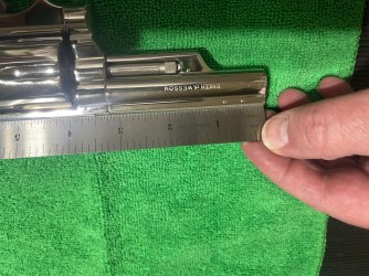

Thank you for the affirmation of factory nickel finish. I pulled the side plate and gave the internals a good cleaning and used some Mothers on the nickel. It cleaned up pretty well considering what I started with. Stocks are being refinished with tru-oil. Barrel pic included for input regarding roll mark being off center and possibility of barrel being cut down. It currently measures almost a perfect 4"

The 4" and 6" Combat Magnum front sight ramp was a seperate piece cross pinned to the barrel until around late 1969, the blued versions pins were usually ( not always) polished flush.
Nickel 19 barrels were plated with the ramp off, the front site ramp was finished in blue and was pinned on later and the pins were left "proud".
Beginning around late 1969 early 1970 during the Model 19-3 production the factory began making the fs ramp integral with the barrel ( note the fs "blade" was still pinned to the ramp and polished flush).
Nickel 19-3's began getting nickel coated ramps and blades late 1969 early 1970.
On a side note the Model 66 was introduced just after the change so unfortunately none have a pinned ramp although the earliest examples do have a K serial prefix.
Imo your barrel looks correct.
While 4" and 6" nickel 19-2's are always found with blue fs ramps and proud pins nickel 19-3's are rarely found with blue ramps, my guess is not many nickel 19-3's were made between the dash 3 revision change around 1968 and the integral ramp change in 1970.
