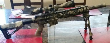

Well after watching this forum and debating, I finally purchased a 15-22. It was a regular black color with threaded barrel. Local shop was running 20% off for month of June and got it new for $378. I immediately painted it and started adding the folowing accessories:
UTG BP88Q bipod
Tacticool Barrel Shroud
Burris PEPR mount
Vortex Crossfire II 4-12X44MM
Hogue Grip
Magpul XTM Rail Covers
Magpul Rail Handle
Extra Mag
ALG Combat Trigger (ACT)
JP Yellow Springs
KNS Pins
Magpul STR Stock
I've shot 100 rounds so far and love this gun! I'm surprised how accurate it is. I think my bolt gun will be neglected now. I'm slowly researching what ammo works best in this gun. Federal bulk is what I've shot so far. The very first round was a ftf, then flawless.

Congrats on your purchase. Nice paint job.

Good golly what a rifle! I don't know much about all the additions you made, but it really looks great. The 15-22 is an outstanding rifle, it is what everyone else is trying to produce. S&W got it right and everyone else is everyone else. The CCI Mini-Mags have in my rifle been perfect. The same is true of Federal Champion. The Norma .22 LR have been perfect. It has run perfectly with Remington Golden Bullet .22 LR ammo. It is my most used and most enjoyed .22 rifle. When I take it to the range, it is the rifle other folks want to look at and shoot. Especially when shooting action targets, it is unsurpassed.

Congrats on your new lead slinger. Good looking. You got more $ on it than IN it. :)
