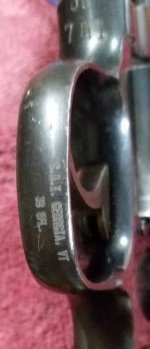

Here's a poor cell phone pic of the "minimized" import mark. By
planishing it, the mark feels like a normal roll mark instead of
a bunch of lazer craters. Also in the very top of the pic you see
the JP 741 police stamp.
It wasn't defaced, just smoothed.
