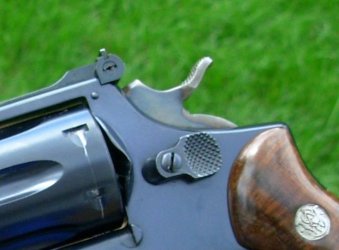

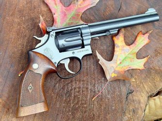

My 1951 K-22 Masterpiece (6"), serial # K 130417 has a Fishhook Hammer. Did S&W routinely put those in guns and if so what eras, models etc? Or were they all an accessory part? What is their purpose or advantage?
In the late 1940s, when the postwar Masterpiece line was introduced, it received the High Speed Hammer (S&W's name for it). It is what many collectors refer to as the "fishhook hammer." In the spring of 1948, the M&P started getting the same hammer.
By the mid-1950s, it was pretty much gone. I have a .38 Combat Masterpiece that shipped in October 1952. The High Speed Hammer was in use at that time. My 1956 revolvers do not have it.

I owned 4 or 5 K-22's all from 1948-1951 and only this current one had the Fishhook. I guess the others got changed out with later hammers. The K22 family heirloom was definitely changed as it was a 1950 gun with the wider target hammer from 1955? or there abouts. I gave that gun to my sister as she lives on the family homestead where we all shot that K22; it was the first gun many of us ever shot.
