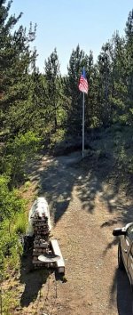

I bought a twenty-foot fiberglass mast in 2021. I wanted steel,
but the cost and shipping was prohibitive. I started out skeptical
due to the wind ratings: 70 mph without a flag; 40 mph with one.
It's been fine. We've had 60+ when the flag was flying and more
than 110 when it wasn't.
The two-piece mast slid into another fiberglass sleeve I had set
in concrete, four feet deep (the mast is twenty feet above
ground). I shimmed the mast inside the sleeve. Works fine.
I've seen the flag wrapped around the pole a very few times.
It's not a concern.
