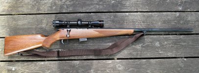

25/20 Savage Model 23
Good advice on sizing the necks down a little at a time. I use an interchangeable collet style neck sizing die to do that. I can also neck size my 32/20 brass with that die too.
My 25/20 Model 23.
