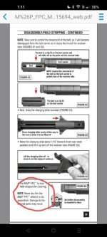

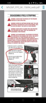

I'm willing to bet the "something flopping around in there" is the hammer because you dry fired the gun with the bolt removed.
Field strip again and remove your bolt. Reach inside the ejection port and recock the hammer with your finger. You'll need to use your big boy finger but it can be done.
Then reassemble and your issue should be gone.
And for any time you field strip, don't drop the hammer with the bolt out or you'll have to recock the hammer manually. You can always put the gun on safe before field stripping in case you forget and pull the trigger. It's really no different than dropping the hammer on an internal hammer pistol with the slide off, except you can't see inside to realize you did it.

Dam! I wish I would’ve read this before I send it back. You’re probably right, but I don’t remember pulling the trigger with the bolt out. I did try to push that all the way back to reset it, but I couldn’t get back there far enough to do it and I wasn’t sure that was even the problem. I read the manual from cover to cover, and it said nothing about not pulling the trigger with the bolt removed but you make an excellent point. Thank you for posting that. Smith Wesson said four weeks for the return which will probably turn into six.
Recocking the hammer with your finger is possible but after further experimentation, I found folding the gun and coming in from the front of the receiver with either a flat blade screw driver or a 1/2"-5/8" dowel rod is way easier. Just look out for the fixed ejector when your reaching through to the hammer.
If the bolt assembly slides right in to home position then more than likely your hammer was dropped.
It did you’re probably right it did slide all the way in without any force. I sent it back and hopefully they also replace the bolt that other people are having issues with while they have it.
