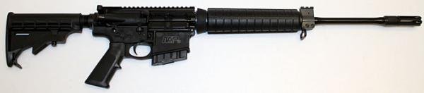

Just purchased an M&P 10 (811311). I am currently deployed overseas so I'm not able to get my hands on it at the moment. I want to remove the lock ring and stock hand guards and replace it with an aftermarket free float hand guard (to be determined). What length hand guards do i need to be looking at? I want to get some new "furniture" ordered so i don't have to wait for shipping times to make any changes upon my return home. Anyone have any pictures of their custom M&P 10s would be outstanding also.
Thanks, mine is pictured below still stock.
It is a mid-length handguard. I believe that is 9.2 inch rail if you retain the factory gas block. The Factory gas block is rail height, so you need to get a low-profile front sight. Do not get gas block height as that is too tall.
