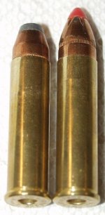

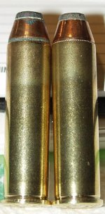

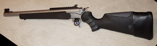

I would not hesitate to shoot an elk or bear with my 17" Encore 445 using a 300 grain bullet at 1850 fps.
