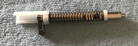

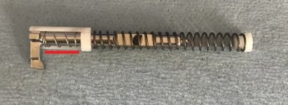

Below is a typical M&P striker. I've removed the retaining collar/keeper to allow the springs to full extend and reveal the striker return spring (just above red line). You may need to click on the image to get the full size.
Normally you don't see the spring with the striker assembled since the main striker spring is much stronger and fully collapses the return spring.
