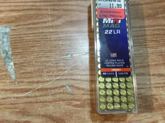

I found that my Glock doesn’t like lead bullets from the Winchester bulk pack.
So I get about 98% reliability with CCI Mini-Mags copper plated solids.

Yes, G44s like 40 grain copper plated round nose, over 1200 fps.

LVSteve...Both. Although, I really don't like screwing around with a loaded gun in my house. (Don't ask, don't tell!) Okay, so yesterday I was a little bored and pulled out my G23 just to look, etc. That one has the same "issue" of having the little resistance at the same spot, so I'm going to try different ammo like Sgt Rock 11B suggested. If that CCI works, I'll never buy anything else for this gun. (Of course, duh!!) I will be back with a report after the range trial. I think those are the only two Glocks I have, but I'm thinking the little resistance is a Glock thing. But man, this is a nice little gun, and .22LR is a great cartridge. I could practice in my back yard if I had a muffler for it.
