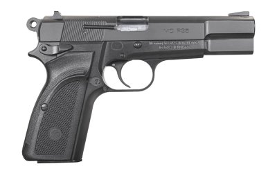

Pic #1 My aged BHP born in 1978. Mods done by F. Bob Chow of SF: extended slide stop, extended safety, mag disconnect removed, matt black top of slide, mirror finish blue to frame and slide that's now well worn. I added hammer spur cap and later CT laser grip panels.
Pic #2 My Girsan MCP35 PI OPS bought in 2023. Out of the box no mag disconnect but had 10.5# trigger reduced to 4.75# by local gunsmith. Added CT Micro Rad optic with 3 MOA dot. IMG_1460.jpegIMG_0263.jpeg

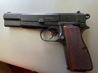

Don't know about INGLIS finishes - BUT TISAS BR9-SS IS SOLID STAINLESS (not sure if they are still importing the Stainless "REGENT")
Including pix of the build quality of mine, Nicer quality than FN, FEG, INLIS HP Clones I've examined. Grips are rubber Uncle Mikes designed by spiegel. I remove Magazine safeties from mine, to improve Function.
