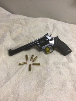

Another recommendation:
.312” 100gr Hornady XTP; 11.5gr of H110, Starline brass, Federal 100 primer. 1,300fps.
25yds resting on p/u bed.
