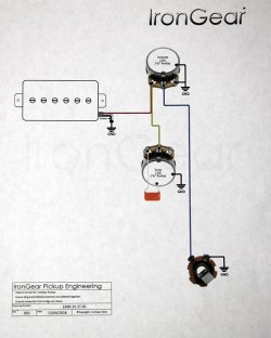

I do like the simplicity of the circuit for a single pickup guitar. This is the wiring diagram and electronics setup for my '60s Japanese starter guitar I have been tinkering with on and off for the last couple months. I think we are getting to the home stretch. I like to use as much of the legs on the tone capacitor as I can when wiring something up. Tomorrow I will do the soldering.JapJuniorElectronics.jpgWiringDiagram.jpg

IIRC, single coil pickups were often 250K/.047uF and Humbuckers were 500K/.022uF.
What reading do you get with a meter set at Ohms?
Single coil or Humbucker?
I have schematics for most Fender guitars and amps, from an earlier life.
It is a vintage style neck P90 which are a bit warmer and I wanted to keep the more high end, so I went with the 500K pots and .022 cap. This was also the most recommended combo for P90 when I went searching the internet.

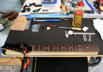

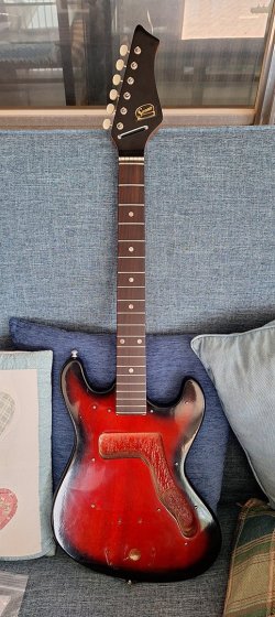

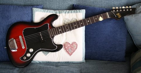

Finished up the Sorrento single pickup guitar today. The wiring was all soldered up this morning and checked. This afternoon I installed the pickguard with the new electronics. I then installed a Les Paul style bridge in the proper location, unlike the original, which was about 3/16 off. Now the intonation is spot on. I was about a millimeter or so off getting the P90 pickup centered,but I am not going to worry about it. The relief is now .012, which is half what it was before. The action height is 2.0mm on the low E and 1.75mm on the high E. I did not realize at the time I bought the new bridge that it was a 12 inch radius, which was not mentioned in the description. If it was a 9.5 inch radius instead I would be able to drop the action a bit more. Not going to complain though since the action was between 5 and 6mm when I got the guitar.
I think it should be playable now. I need to contact my amp tech and set up a time to take a couple of these guitars up to his shop so he can test them out for me and let me know what he thinks of the setups. I will try and remember to get some video/audio of it when I do.1JapaneseSorrentoRestomod.jpgSorrento1.jpgSorrentoNeckWork.jpg
