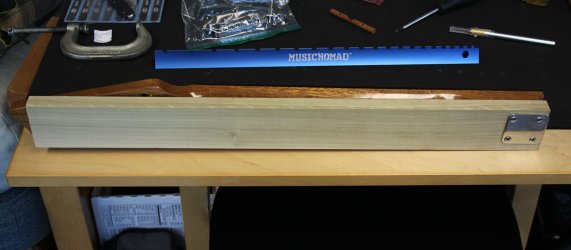

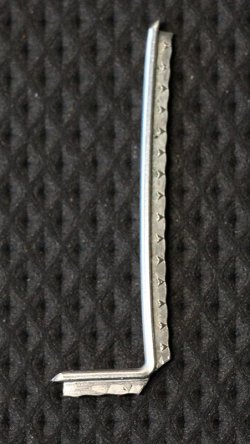

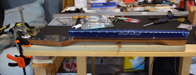

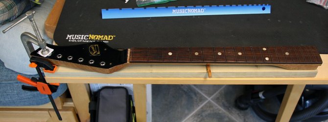

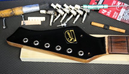

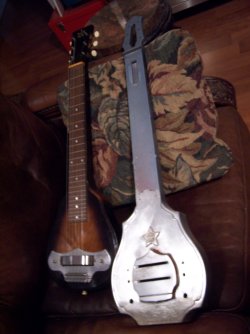

Started a couple days ago with a more challenging project. 1960's Japanese starter guitar for kids, with the body about 75% normal size and a 23.5 inch scale length. The action was about 5 or 6mm and there is no adjustable truss rod to straighten the bow of the neck. I have compression frets coming to see if I can work that out while changing all the frets. The old frets were so worn I had fun getting some of them out. I pulled the 6 inline, one piece tuner assembly off as well as the tuner bushings. They will be replaced by vintage Tele style tuners. Tonight I made a neck jig from a scrap piece of poplar from the nearby Home Depot. Attached the neck to it with the 4 screws and mounting plate from the guitar. Used a wooden dowel with a leather washer superglued to it as the pivot point and a couple clamps to attach it to the table and adjust the neck to straight so I could go over the fretboard with a 9.5inch sanding block. 60, 150, and 400 grit were used. When the frets get here Friday I may spend some time working the bow out of the neck. This will be interesting since this fretboard has binding. I use a homemade fret slot depth tool made from a old fret cut and bent at 90 degrees with the barbs filed off to check the slots were still deep enough after sanding the radius. A nice little trick that saved me from needing to buy another tool for that.

Teisco Del Ray has a cult following. They were the very definition of El Cheapo. They were hard to play and sounded horrible. I had many come across my counter and bench. There wasn't much point in trying to improve playability and tone as their fan base wanted no changes and everything kept stock original.
Most of them sold for around $50 but now command 4 figures.
I bought this one for $150. It actually sounds pretty good to my untrained ears. The only thing I can pick on a guitar is the opening notes of Metallica's 'Nothing Else Matters'. Since they are standard tuning open string plucks I can handle that much 😄 . The clean tones from this guitar were not bad at all on my Crate test amp.
