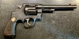

This is my first post on this fabulous forum. I am hoping someone will have some info for me. I’ve always wanted one of these large frame 455’s and just purchased this one yesterday. Eagerly awaiting arrival.
I only have the photos from the auction site for now, so not all the markings are visible. It has adjustable sights. Serial #8746 - left side marked with British broad arrow, beneath that is a crown mark of some sort, and beneath that a Roman numeral two, “II”. Left side of barrel marked Is “Smith & Wesson”, right side of frame has the big logo, and there are no caliber markings that I can see on the barrel.
Any additional info would be much appreciated. Thanks.

Welcome to the forum.
You won a pretty nice ".455 Hand Ejector 2nd Model" with after market sights added. It'll be a great shooter.
It's of the 3rd variation made under contract for the British Commonwealth:
3. “.455 Mark II HE - 2nd Model” (sans extractor barrel shroud and 3rd lock), and the cylinder ctr pin hole in the extractor star is reduced .020” with the associated Ext Rod rear tip reduced .020” in diameter from the TL versions, the ".44 HE 1st Model Triple Lock" factory converted to .455, and the ".455 HE 1st Model Triple Lock" produced in .455 (documented in Neal & Jinks Pg. 215-16.) This version was referred to as the MK II revolver by the British and stamped ‘II’ by them, upper left rear side of frame. The 2nd Model continued in the .455 1st Model TL Brit serial range and beginning ~#5801 (previously thought to be 5462) to #74755, shipped 1915-17.
By Feb 1916 724 were manufactured for the Canadians, chambered in 45 Colt, without a cartridge roll mark on barrel, presumed for the RCMP [H of S&W, 3rd ed., pg. 203]. #74744
Another 15 in 45 Colt were sold commercially in 1916; likely “over run” guns from the above order with consecutive #s. Only#46748 is known.
The Canadian military also bought 14,500 .455 2nd Models [H of S&W, pg. 203].
And 1105 2nd Models were released for commercial sales in the US, shipped Dec 1917 to Shapleigh Hardware in St. Louis [S&W, N&J pg. 216].

One of the collectors (Sixgunstrumpet) on this fourm has/had several fixed sight guns that were modified like yours. Hopefully he'll come along shortly and chime in... I have always liked that modification.
Thanks for sharing and welcome to the forum.
I've never seen one but 'The Book' (SCSW4) says a few of the earlier .455 Triple Locks were factory-fitted with a drift-adjustable rear sight blade in order to be permissible for Bisley (England) competition.
I doubt the 2nd Model pictured above is factory, but odds are good, that is what it was converted for.

Welcome to the forums from the Wiregrass! That's a second model .455 Hand Ejector that was in England probably from World War I was proofed at Enfield and sold out of service. I can't tell if there's still a Ledge in the cylinder Chambers or not. It could have been reamed for 45 Colt. The sights were probably added after it left service.
Guy
Doubt it is 45 colt. Back of cylinder not shaved because you can still see the serial number and no recesses around the chambers for the thicker colt rims. I don't think the recoil shield was shaved either because the gap between the rear of cylinder and frame looks kind of tight. Plus if you look hard it there does seem to be a bit of shadow ahead of the carbon spots where you can look in the chambers on the last picture of post #8. I may be wrong and recoil shield trimmed and shadow is left from where reaming started.
Interesting and simple sight mod that appears fairly well done. Odd that whoever used one pin and one screw. Wonder if rear of front sight is set up so you can loosen the screw and pivot sight up or down a bit on front pin, then tighten to lock in place for minor elevation adjustments. It does appear to be a assembly of parts from several guns.
That's a very unique .455 2nd model!!
The front adjustable sight blade is clearly the Colt design first used on the Model 1873 SAA and Bisley SAA Target models (along with a drift adj rear sight blade) in the 1890s for Bisley matches. So an adjustable front blade may have been allowed at the time. Colt also used these target sights on pre war Colt DA target revolvers. Loosening the rear screw does allow the blade to move up and down for elevation adj.
Your .455 certainly may have modified sights for the Bisley Matches. A front adjustable sight is not now allowed. However I don't know that they weren't allowed during the period of your .455. The Colt front sight on their target guns of the period were certainly intended for the Bisley matches, therefore the name "Bisley" used on one of their models.
Adjustable rear target sights for the Bisley matches were limited to windage drift adjustment only. Hence why so many factory and aftermarket windage-adjustable-only rear sight blades were added to fixed sight S&Ws instead of using factory adjustable sights. Here's an example of the S&W factory Bisley legal rear sight installation:
One of the collectors (Sixgunstrumpet) on this sight has/had several fixed sight guns that were modified like yours. Hopefully he'll come along shortly and chime in... I have always liked that modification.
I totally missed this, apparently was a little busy at the time the thread first popped up.
Jim, in the above post, outlined exactly what I think is going on here.
The only thing I can add is that I've only successfully identified two specific "fixed sight target" jobbers; Frank Pachmayr and DW King, and this particular job does not share any features of either of those.
I will say that whoever did the work was good, certainly one of the best jobs of this type I have seen.

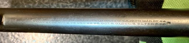

Thank you for all the feedback. I now have additional photos of my new revolver. After doing some research on this forum I discovered a mismatched serial number. I am enclosing closer angles on the markings and the sights, which I am curious about. Any info greatly appreciated!
I presume that the #s on the yoke and in the yoke cut out of the frame are those you consider mismatched, But I'm happy to confirm that they are not because they are not serial #s, they are assembly #s.
SERIAL # LOCATIONS: To confirm all parts are original, one can check for the 6 (or 7 - Triple Lock models only) matching serial # locations for fixed sight pre war Hand Ejectors and all post war Hand Ejectors thru ~1956 and a few as much as 3 years later.
NOTE: Observing serial #s with accuracy or even existence, especially on penciled stocks, requires magnification, bright light, and an attitude that it is there!
