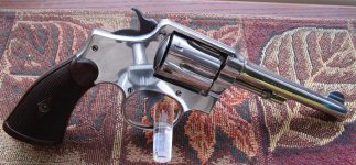

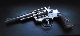

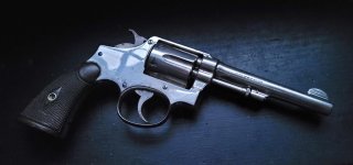

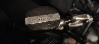

I picked this up yesterday. Does anyone here have one that letters close to this serial number so I can narrow down the year of manufacture? From information I've gathered on line and from the SCSW I'm thinking it's in the 1919-1922 range.
It's far from perfect but the timing is good and lockup is tight. Finding .32-20 ammo is apparently going to be a bit of a challenge however. And it sure isn't cheap.
This is my first .32-20.

Thank you for this. I'm pretty confident it's 1920.
But wait there’s more! The Famous Dodge City 5 inch,, serial number 799xx ca. 1917
Your revolver also appears to have a 5” barrel (?), and it is caliber stamped.32 WCF (1914),, and it is Nickel!!! And one more thing, the roll mark on the left side of the frame,,, (screams) 1923!! to me.
The gap between the 799xx gun (rounded to 80xxx) and the two 80xxx listed above,,, contains an entire World War. You have a very interesting revolver with (I believe) a heat treated cylinder and the ‘23 ? frame. I like this one, the Wood too
I own, #85057 and it shipped in March 1920. There are a few in the old S&W database from 84,000 to 90,000 that shipped in 1920 as well. 32-20 heat treating began in 1919 at approximate serial number #81300.
Yes. The barrel is 5".
As Gary noted, the 32 W.C.F. CTG cartridge stamp lasted until the spring or so of 1922, before it was changed to 32-20 CTG.
The small roll mark was reintroduced on post-WWI revolvers in about 1920.
The absence of Made in U.S.A. on the frame pretty much ensures this is not a 1923 revolver. All known facts about twaits' newly acquired .32-20 HE point to likely shipment in 1920, not later.
The small roll mark ,,( see image) ,, I was questioning is the smallest (.35?”) S&W Logo appearing on the left side of the frame. I’ve noticed the small stamp on the left without the USA stamped on the right on serial numbers 100xxx and above.
