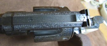

Handejectors comment about the sights being possibly Stainless?..
I don't really recall now..
I did, at the customers request put a gold line inlay in the sight blade on the rear sight. That's in one of the pics.
I had to have taken the rear sight all apart to have that blade itself to work on in the vise.
I may have simply left the blade polished in the white.
Then have polished the rest of the rear sight assembly parts to 'In the White' as well.
Then reassembled the sight.

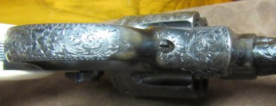

The cylinder face, ejector rod, cylinder release and sight assembly are areas that you do not usually expect to see engraved, even on a "full coverage" Revolver

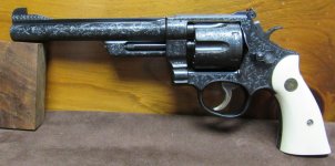

In 1990 a long time Forum member here, Model39 (sadly no longer with us), commissioned Jim DeMunck (2152hq), another long time Forum member, to engrave a S&W 629 for him. He asked that it be "full coverage engraving with gold inlay." I think he more than got what he asked for.

Thank you Jeff for showing us your Model 629 with Jim DeMunck's wonderfully performed "full coverage engraving with gold inlay".
As the above Reply's have expressed, probably won't find one nicer. And thanks for sharing that with us and an extra special High 5 for the great photography showing all that wonderful detail.

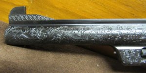

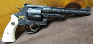

Here are a few pictures of my my S&W .38/44 Outdoorsman, SN S123159 (1954+/-) that I got from Jim 12 years ago. I posted some pictures of this gun on another thread a couple years ago, so some of you may have already seen it.
As you can see, it's another fantastic job done by Jim. Those are ivory grips that I think Jim said were from a Colt SAA. Please note that he moved the S&W logo from the right side to the left.

Jeff, here are 5 more pictures of my .38/44 that Jim engraved. (5 more to follow in next Reply.)
Bill
