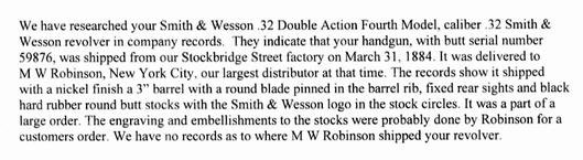

I would be very surprised if that was NOT factory work. It's a $100 gamble but I'd take the chance. It's a very nice and above average example of a Model 1 1/2.
I agree--it's a beautiful revolver! I picked this us revolver last year for $250 and just to make double sure that it was a NYC engraving, and not factory engraving, I sent off for a letter. It confirmed that it left the factory without engraving and was sent to MW Robinson in NYC.
I've been asked...here is the excerpt of the Letter of Authenticity that applies to this post. BTW, the letter says that the revolver left the factory with black rubber grips, but the mottled grips are numbered to the gun. I assume they were put on there when the revolver was sent out to be engraved in NYC

I find it interesting that the mottled stocks are numbered to the gun. This must have been a way for MW Robinson to keep the parts of a gun together after the engraving the same way that S&W reunited the parts after finishing. The mottled stocks that left the S&W factory generally are not numbered. The late Ed Cornett (opoefc) had the ledger(s) from the Stocking Department that verified the type of stocks that were originally on the various models of Smith & Wesson arms.
