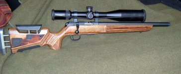

A couple thoughts on mounts for the CZ 457. PIC Rails with built in elevation are popular with guys doing a lot of long range shooting (150 yards or beyond) as some scopes run out of elevation adjustment when shooting the .22 lr at long range.
Personally, I don't care for the look of the pic rail, it makes access more difficult if needing to clear a malfunction, raises the scope higher than needed, and with this rifle, I don't shoot past 100 yards, as it is mainly set up for 50 yard matches.
I run 30mm Talley split rings on the rifles 11mm dovetail. Perfectly secure with no POI shift. Because of the 50mm front objective on the scope, I run medium height rings.
Nothing wrong with either way, really, more personal preference and intended use.
TIP - Both my CZ's love SK Standard Plus, and Rifle Match ammo, as in 1/3-inch groups at 50 yards, or better. Under an inch at 100 yards on a calm day. Might want to try a box.
Also, Those adjustable triggers on the 457 are pretty nice, but if you really want a light trigger, there is a replacement spring by a company called "Yo Dave" that will get you under 12 oz.
Larry
