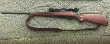

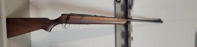

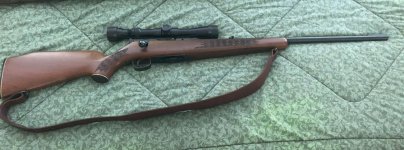

Back in May I found a replacement for one of my "youth" guns that was a varmint killer anywhere from 75 to 200 yards when I was a teenager with decent eyes. My real youth gun was a Savage 340 (1962) with iron sights in 22 Hornet, and the replacement I found last May is a Savage 340E (1974) also in 22 Hornet, but with a Tasco 3 to 9 x32. I know cheap scope but the early Jap glass was decent enough quality and it still performs decent for me.
VERY "low budget" rigs but do get the job done, still a lot of fun and the range use has reduced size (200 yard) targets placed at 100 yards so we can shoot and zero and compete with our M1 Garands.
sounds to me like you already have not only 1, but 2 rigs already to go for varmints or paper whichever you are chasing while down south...
