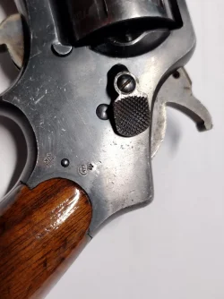

Going by the proof marks and other markings it is a former British Service Revolver, one of the many S&W supplied during WWII. Original caliber is the 38 S&W cartridge though many have been reamed to accept the longer 38 Special round. The broken firing pin tip can be replaced without replacing the entire hammer. Any good gunsmith should be able to do this for you. Can also be done by a do it yourselfer with a little care. Firing pin tip and the retaining rivet should be available from a few online sources.

Nice! Can you give the number on the guns butt, where the swivel is mounted? It should start with V. I think the g45094 number you gave is just an assembly number from inside the crane. With the SN we can have a good idea of the gun's shipping date.

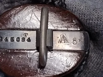

Hi There,
I agree this is a very interesting revolver. What I notice
are the 'Flaming Bomb' stamp which would indicate
this revolver was inspected by the U.S. Military. And
there is a 'Broad Arrow' by the serial number which
indicates this revolver was used by the Australian Army.
Cool!
Cheers!
Webb

Hi There,
Cool!
Cheers!
Webb
On my examination of the butt picture- though hard to tell for sure, and a bigger clearer picture would Help a lot- it looks like a broad arrow wrapped with a C which would indicate Canadian use?
Thank you all for your great information. My dad was CIC during the Korean War in Canada and said he had this from then. Don't think that is 100% accurate, but at 92 I'll let him think that. Here is a closer look at the butt. He did "snap pin" he said because my Mom would not lethim keep if working...IMG_20251002_113950494.webp
Jaymin:
From the Victory Model Database it appears that your Dad's revolver likely shipped from the S&W factory in March or April, 1942. It was a Lend Lease gun.
Regards,
Charlie
