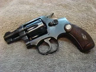

If you don't have to have a top break, the .32 Long I frame Hand Ejector is my recommendation. Right after WWII they introduced it with a 2" barrel:
Pre war models made from 1896 to 1940 numbered over 530,000 and easy to find, and under $300 depending on condition as always.
POST WAR .32 HAND EJECTOR & REGULATION POLICE MODEL examples of each of the post war evolutionary models with evolutionary changes briefly described. These are harder to find, better condition, and higher priced generally.

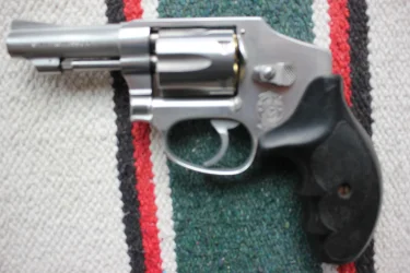

I really liked the six shot 3" 632 centennial in 32 h&r magnum for carry. Like duke2002 said they have become harder to find and expensive for an everyday carry gun.IMG_1941[1].webp
The current production Ultimate Carry J-frame is a fine revolver assuming you get a representative sample. if you want something older the .32 regulation police is also a very cool carry gun, if a bit elderly. The Ultimate Carry is chambered for .32 H&R magnum though I suspect the .32 regulation police could safely be bored out to accept that cartridge if you really wanted to. Either would make a perfectly decent CCW gun if you are happy with the caliber. (I own one of each and shoot them both now and again.)

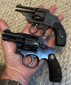

to echo Hondo44’s recommendation, if you aren’t set on a top-break, the early post-war .32 HEs are wonderful little things.
Size comparisons in photos are tricky due to perspective, but the .32 HE is only slightly larger than the .32 Safety Hammerless, and it gives you both the .32 Long cartridge and an extra round to boot.
