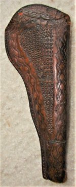

page from 1925 Schoellkopf catalog (scabbards)
I was able to buy / download the 1925 catalog. Having 'security token' issues uploading the (only) page for 'scabbards' in the catalog. Maybe this will help some ID unmarked holsters.
(separate) I found a listing for an early BP SAA with an 'SK' logo stamped on it's accompanying holster. Hesitant to post because it is an active for sale listing. I wonder if 'SK' is ShollenKopf. Based on the catalog images we can see Schollenkopf was not (yet) knocking off the Brauer bros snap strap patent in 1925 :). Most of the Schollenkopf holsters I see listed for sale are the Brauer design. I'll try again to post the catalog page.
It may be hard to read, but the fine print at the bottom of the page says the patterns are 'relief stamped' (I assume, not carved). Probably sewing machine chain stitched too - not 'saddle stitched'. Would be fun to find one with the 'giant' markings that matches one of the patterns in the catalog and discuss the details of construction. Clearly, not the fine workmanship of Brillalikes used by professional LE of the day.

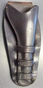

Been working the holster search for several days now. Probably wrong on some levels, but right on others.....three days ago I spotted a holster for sale 175 miles down the road in Austin from an estate sale guy on believe it or not Etsy. The price was good, and I had no idea what it would fit but took a chance on it because it was made by one of the shops Red identifies as TX Ranger suppliers; SA Wade in Rosenberg TX. It arrived today. And....amazingly it fits my 5" model 1899!

Your Wade will 'fit' your revolver, ignoring that the strap closes, when you can turn the holster upside down and try to shake out the revolver. That welt inside the main seam -- just one on yours, up to 3 on a late Brill -- is meant to clamp the frame into the holster pocket.
well by those standards, the holster is too big then. Cause it isn't that tight....
It fits that tight on a 44HE, and a 1911, but the strap is too short.
It fits that tight on a 4 3/4 SAA...and the strap snaps, so clearly that's what it was made for. Thanks for prompting me to check it out.
