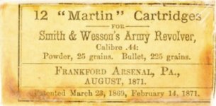

It’s possible that the 44 American revolver purchased and issued by the US Army may have introduced the first inside lubricated pistol bullet.
I have never seen an original 44 American cartridge manufactured by the Frankford Arsenal in 1871. See photo.
We know for a fact the Frankford Arsenal manufactured hollow based bullets to fill voids from undersized bullets used for oversized bores.
When exactly they adapted the inside lubricated bullet is the question. 1873 for sure but was it a little earlier with the 1000 Americans ordered by the US Army?
You’d have to pop a bullet out of a very expensive antique 44 American Frankford Arsenal manufactured cartridge to confirm it.

I've seen some information that negates the idea that the
Frankford Arsenal made hollow based bullets for the early
.44 S&W American. The Frankford Arsenal didn't start making
ammo for the .44 S&W A. until early in 1871. The earliest date
known on ammo boxes from the Frankford Arsenal for .44
S&W A. is April, 1871. These first cartridges were very proble-
matic and frequent misfires were encountered.
AS one can see, this excerpt from The Pitman Notes... the
cross section of the bullet doesn't show any hollow.
Cheers!
Webb
