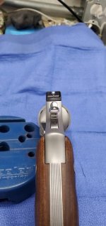

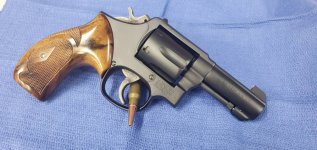

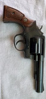

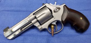

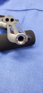

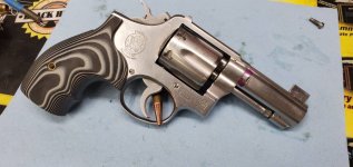

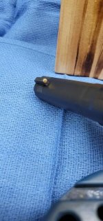

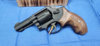

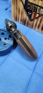

First up started as a 10-8 4" SB converted for carry.
20191129_032351.jpg20191129_032331.jpg20191129_032440.jpg20191129_032224.jpg20191129_032254.jpg

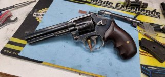

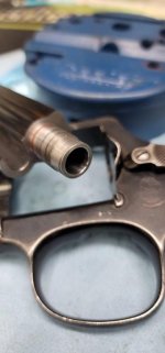

Next up is a security six that was in bad bad shape. Thankfully we were able to save it!
20190729_091506.jpg20190811_091202.jpg20190811_095911.jpg20190929_090503.jpg20190929_090520.jpg

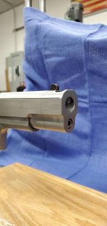

This one was a beast. Caspian frame and slide base. Some of the highlights was a slide chop and coned compensator install, square trigger guard via cut and weld piece in, gold line front sight, machine checkering etc etc. These are pics before it went home for bluing.

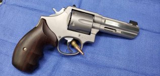

681 we swapped a performance barrel into. Stabbed barrel, shroud, polished flats and sights.

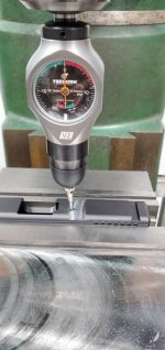

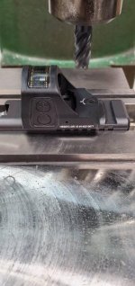

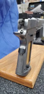

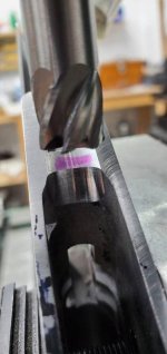

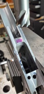

Little 1911 work
20210124_122636.jpg20210124_124820.jpg20200630_040935.jpg20210125_114033.jpg20211003_094317.jpg
Probably the last post for the evening. I'll try and get more up soon.
20211005_061006.jpg20211005_061722.jpg20210125_103528.jpg20211009_130740.jpg20211009_132011.jpg

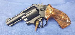

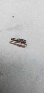

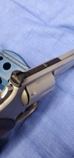

Model 66 rework. The sights were fun. C&S rear that we welded an extension to and front made in house then shipped for tritium install.
20210724_092720.jpg20210724_092750.jpg20210724_092901.jpg20210724_092850.jpg20210724_092943.jpg

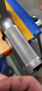

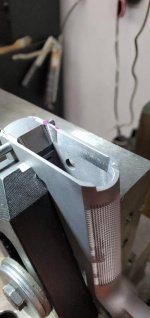

Gen 2 Chen checker and install.

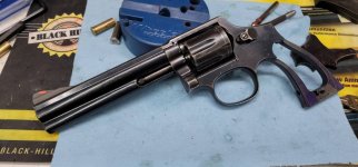

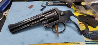

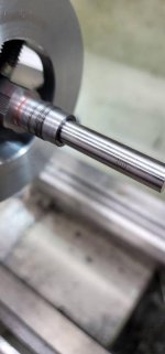

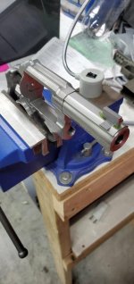

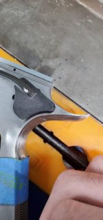

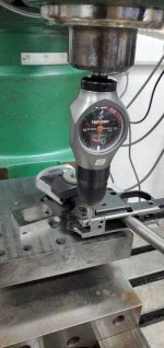

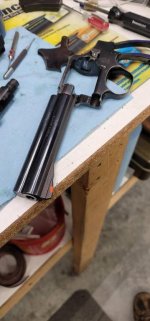

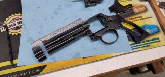

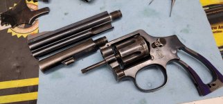

Have a great customer that loves one off everything. This is his 3rd from me. Had an extra 10-8 laying around so we thought why not a 5", RB with a full lug. Found a 586 barrel on ebay last year for $125 surprisingly. Here's the start of the conversion. Had just enough threads left over to pick up on the lathe to deepen. Also decided since we're going for Uber accurate I'd go ahead and cut a Taylor throat. This still needs the shroud modified a bit due to the offset of the L frame bore to ejector. I'll be adding a crane ball lock as well. Maybe two for fun. 20220129_113020.jpg20220129_122753.jpg20220129_124335.jpg20220129_134628.jpg20220129_125412.jpg

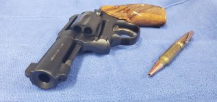

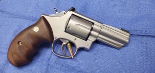

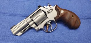

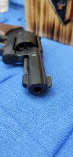

Here's a model 10-8 formerly a 4" SB that's currently at finish. Hope to have it back soon. 20220116_185814.jpg20220116_202012.jpg20220116_202102.jpg20220116_202331.jpg20220116_202212.jpg

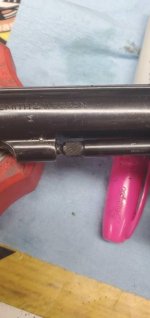

Getting a little closer. Had to adjust the opening where the ejector rod sits due to the K to L frame difference. Got the front end down. Lots and lots left. Thinking about adding a rib on top from front to back for the sight to sit on. 20220205_120032.jpg20220205_125410.jpg20220205_120049.jpg
Sent from my SM-N986U using Tapatalk
Nope... No rib. Look bad. Fixed sight like the above round butts. Much nicer, cleaner.
Roger that! I had thought a little more since that post you're correct! Plus it'd add a chunk of weight that it doesn't need! Lol
