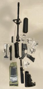

On December 1, 2020 I sent a new, unfired PSA upper to Windham Weaponry to have a 300 Blackout barrel installed. It was completed and returned to me last Saturday, January 23. The original barrel was returned to me minus the gas tube and Delta ring assembly. I replaced the dust cover with one that had “300 AAC Blackout” laser engraved on it. I am pretty pleased with it.
I had a dust cover assembly and a barrel lying around. My son gave me a Wheeler Engineering AR builder/maintenance kit for Christmas so I decided to build another AR. There is a PSA dealer some forty miles from me, so I bought a LPK, charging handle, BCG, stripped upper and lower receivers from him. He gave me a Magpul P mag for buying most of a rifle. I bought the gas tube, Delta ring assembly, and forward assist assembly from two local shops on my way home. I assembled it yesterday. The front sight, gas block, and barrel nut were intact on my old barrel so those were the only parts I did not put together.
I have built several lowers but never an entire rifle. This was a learning experience for sure and an exercise in patience, which I have never had an abundance of. The forward assist was a pain but the gas tube was a nightmare. The tube was just about 1/32” away from centering into the receiver. Nearly two hours were spent tweaking, wiggling, torquing the barrel nut and cursing the various parts. Miraculously it all fell into place. I couldn’t do this for a living.
I spent $350.00 at the PSA dealer, $35.00 for the gas tube and Delta ring assembly, $11.00 for the forward assist. The 300 Blackout barrel and dust cover cost me $260.00, and I had a take-off hand guard. $656.00 with no rear sight or sling. But I did it myself.
