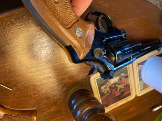

Rode to a shop with my brother today. Picked up these grips (Cokes?). Thought they would fit my K22 (1958) Masterpiece. They fit but are not right for the gun probably for a larger frame (N?).
Anyway I have no gun of that type and I paid $20 for the grips. The grips on my K22 are later vintage than the gun but they are numbered, (shown in the photo) Magna's without diamonds. I would be interested in a trade but without knowing exactly what I have I did not want to post in the for sale category. Since the chances of finding the original grips for my K22 are slim, I was wondering if anyone would be interested in a trade for either the grips that are too large or maybe another set of that type that fit the gun or period diamond Magna's for the gun.
The grips currently on the gun have a number but are much later vintage than the gun itself. Number is shown in the photo.

There is a number 51671 on the frame of my gun ((bottom left). Indication of factory work?
OK Lets get a start on some of your questions.
First cokes are N frame only and have a diamond around the grip screw.So your grips are not coke type. N will not fit correctly unless you find a altered set.
Your K22 is from around roughly 1958-59 so any correct period grips for this gun will have the diamond around the grip screw and also have the black washer on the back.. The target grips you now have are a pretty newer set with the silver washer on back. They do appear to be the correct size though.
You should have no problem finding a magna or target set on the forum. Maybe try a WTB with your year of gun in your ad.

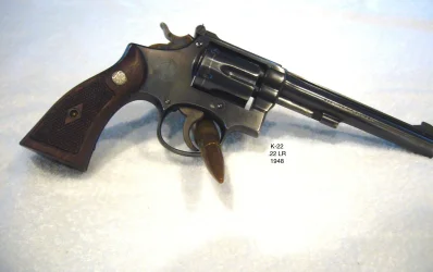

The s/n of your revolver (K323372) does indicate a manufacture date of 1958, so first of all, when you open the cylinder is there a model no. stamped in the cylinder yoke recess along with the s/n? S&W changed to model numbers (Model 17) from names (K22 Masterpiece) in 1957, so yours is either a very late K22 or an early Model 17. The standard stocks for these revolvers are checkered walnut with silver escutcheons and a diamond around the screw. Here is a picture of my 1948 K22 Masterpiece wearing the correct stocks. However, it's possible that S&W offered K-frame target stocks as an option. I'm sure that you could get either if you posted in the Want to Buy section of the Forum. Good luck!
