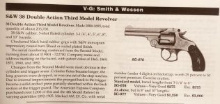

Dear all,
My grandfather passed down to me a revolver that originally belonged to his grandfather. I would like to know with more precision what model it is and the year it was manufactured. It's a .38, and I believe it might be a Model 4, but I'm not sure about that or the exact year. I would appreciate any help, and I apologize if this question doesn't belong in this section of the forum, as I am a new user.
Best regards.

Welcome to the forum. You have a .38 Double Action 3rd model. They were made from serial number 119,000 to serial number 322,000 between the years of 1884 and 1895 so its and antique per the US standards.
Its a great family heirloom.
Welcome
Welcome aboard!
You have a 3rd Model Topbreak. See photo
Also can you look on the back strap of the metal grip frame for any markings?
A lot of these went to police and Express departments.

Markings?
DlanCuartin,
Could you please answer my earlier question regarding markings on the backstrap?
See photo
Often these markings were ground off crudely.
So any grind marks or heavy looking sanding could also indicate a Police or Express gun.
