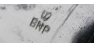

#2 photo of the orig set of pics shows the cylinder proof mark (and that they proof marked every chamber I believe)
..In the same pic, down on the very front forward edge on the left side of the frame is the Birmingham Proof Date Code stamped there.
That will tell you what year the proofing was done by looking up the code letter used.
Here's one chart that's pretty easy to use:
Birmingham Proof House Date Codes
The Crown/BNP mark on the cylinder is the Nitro Proof marking type used since the 1955 Proof Law in England.
(Prior to that under the 1925 Proof Law the Birmngham Nitro Proof Mark was Crown/NP)
What's missing from the revolver are the required Birmingham Definitive Proof Mark (Crown/BP) and the Birmingman View Inspection Mark (Crown/BV).
All of these marks,,the Crown/BNP,,BP and BV are suposed to be within a circle. Each proof mark stamp inside a circle.
The circle denotes the proof are applied to a firearm of other than English mfgr.
The 1955 proof law did away with the 'Not English Make' marking of the earlier 1925 Proof Law. But like the 1925 Law, kept that regulation of each proof stamp being within a circle on non English make firearms.
The 1925 Law did require each chamber on a revolver to be proof fired and so marked.
The 1955 Law did only require every other chamber be fired and marked on a 6 shot revolver. On a 5 shot revolver 3 of the 5 had to be proofed and marked.
Missing markings could be from the polish and plating. But the proofs look like they applied through the plating.
I have read that when the '55 Law went into effect some at the Proof Houses (London & Birmingham) took their time switching to the new rules. So that could explain the 6 cchamber proofs and the newer 1955 Law mark.
But the missing Circle around the mark to show a foreign made firearm,,that was law since 1925.
The stamp used for that was a one piece stamp complete with the circle..not done in 2 steps.
The all together missing View and Definitive proof markings?? Gone during plating/polishing (but it may be that the gun was proofed AFTER plating).. Maybe they just never made it onto the gun.
Interesting gun for sure..

That is not correct. The 1955 Rule abandoned the circle.
However, what the gun is missing, suspiciously, on the barrel is this (substitute 1.15" and 4 tons for .38 Special).
It would be on the left side, or rarely on the barrel flat underneath, for Birmingham. London put theirs usually on the barrel's right side.

Yes you are correct.
The 1925 Law required the Definitive Proof Mark, View and Nitro Proof on the bbl....Crown/ BP,,BV,,NP
All each within a circle on non-Brit made forearms.
The 1955 Law changed that to the Nitro proof mark now the Crown/BNP mark only along with the cartridge info/length/pressure shown.
