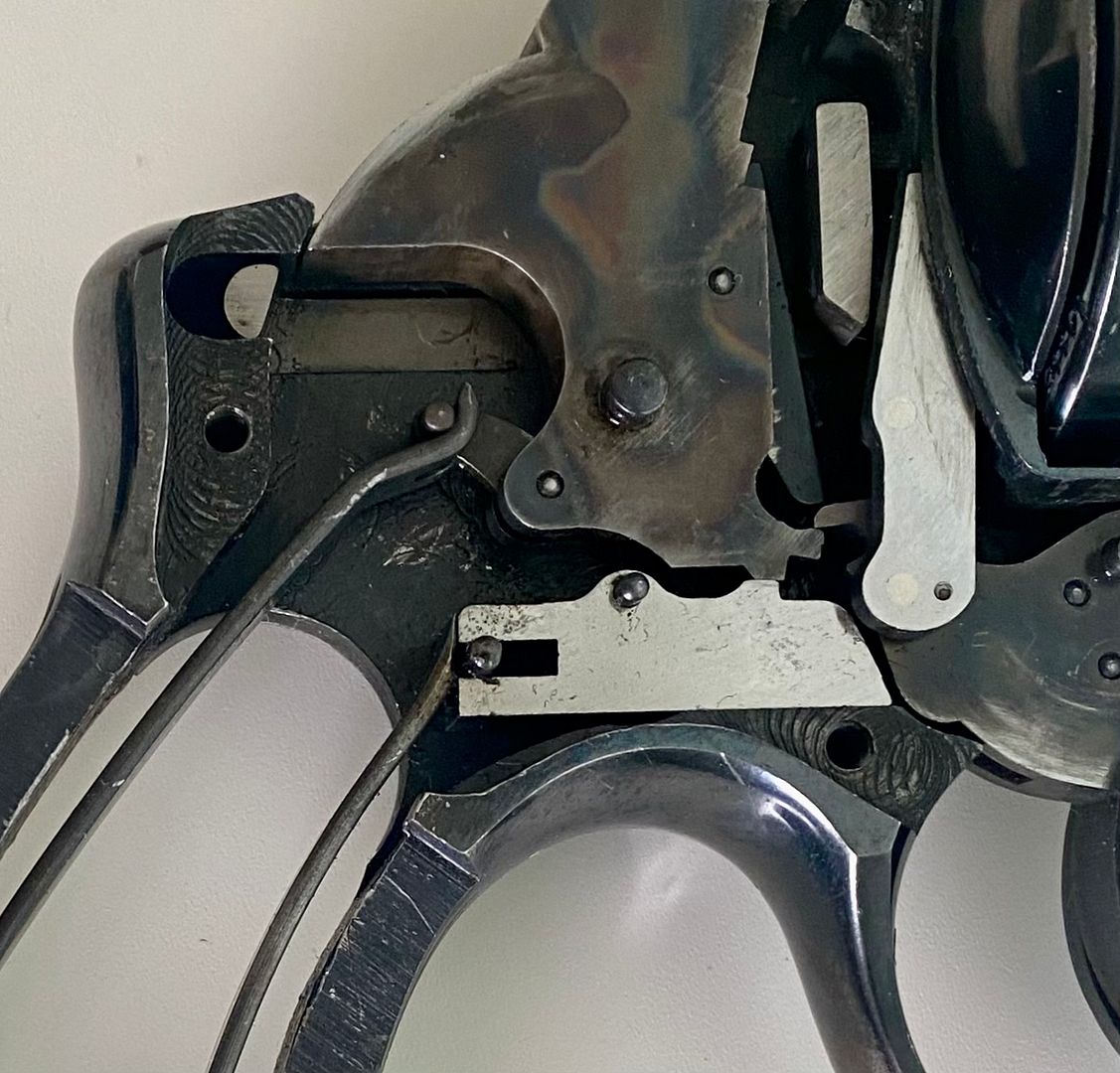

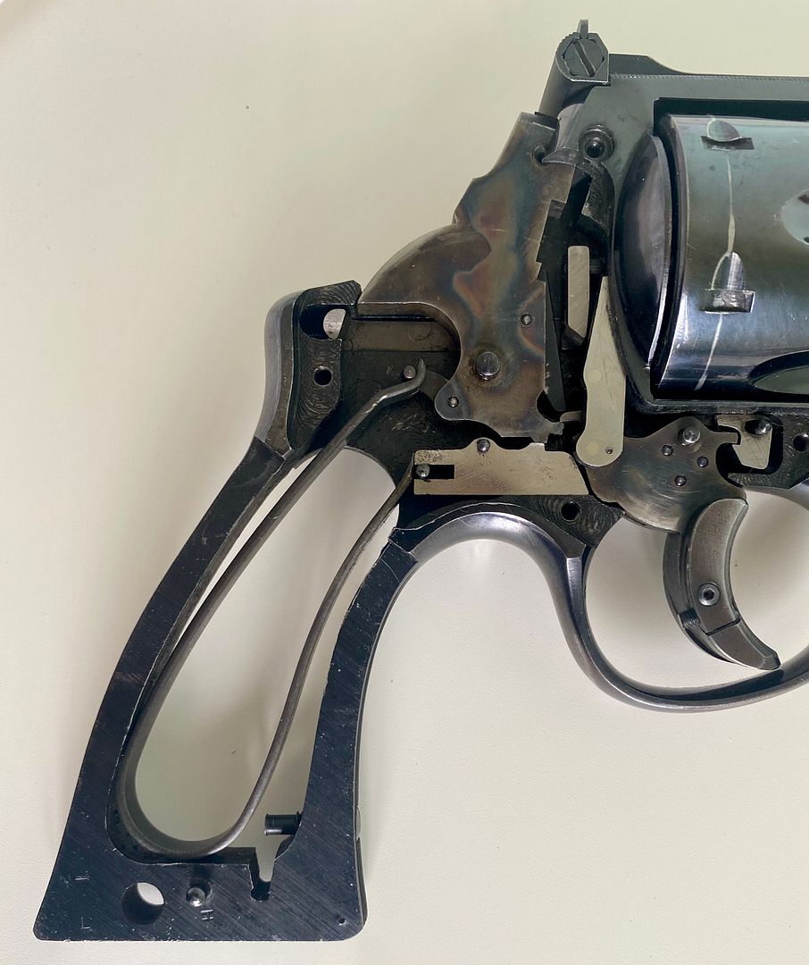

Besides the different spring, what's different under the side plate?
Here is the pre-27 with the side plate off and like Ralph remembered, the U Mainspring also acts as the trigger rebound spring. And it appears that the strain screw is just there to plug the hole in the frame.:)
Possible that the bobbed hammer was part of the improved double-action project.
One of the things my dad liked about Dan Wesson revolvers was that the hammer arc was designed to not move the gun during hammer fall.
Could be that with bobbed hammer the S&W moved less during hammer fall.

The trigger rebound portion of that spring does not look very efficient. How well does it work?
The totality of the U spring works great! To put it in today's terminology, it works much akin to a "Spring Kit".
That said, I have experience with just one, that marketed under Jerry Miculek's name (and previously by him). I say "previously" only because I tried to find his company (BANG, Inc.), and couldn't. I ended up getting mine from Brownells.
I have no numbers for a U/W spring installation, but Miculek's kit is such that you can have any double action trigger pull you want, although he cautions against going lower than 7 lbs. lest you experience failures to fire-----and recommends Federal ammo/primers at that level.
Mine is set at 7 lbs. and works fine with WW ammo (because I didn't have any Federal), suggesting he's being overly cautious----or my trigger pull gauge is lacking------a distinct possibility---even likely.

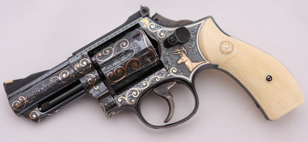

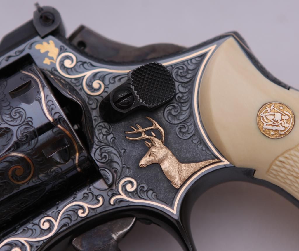

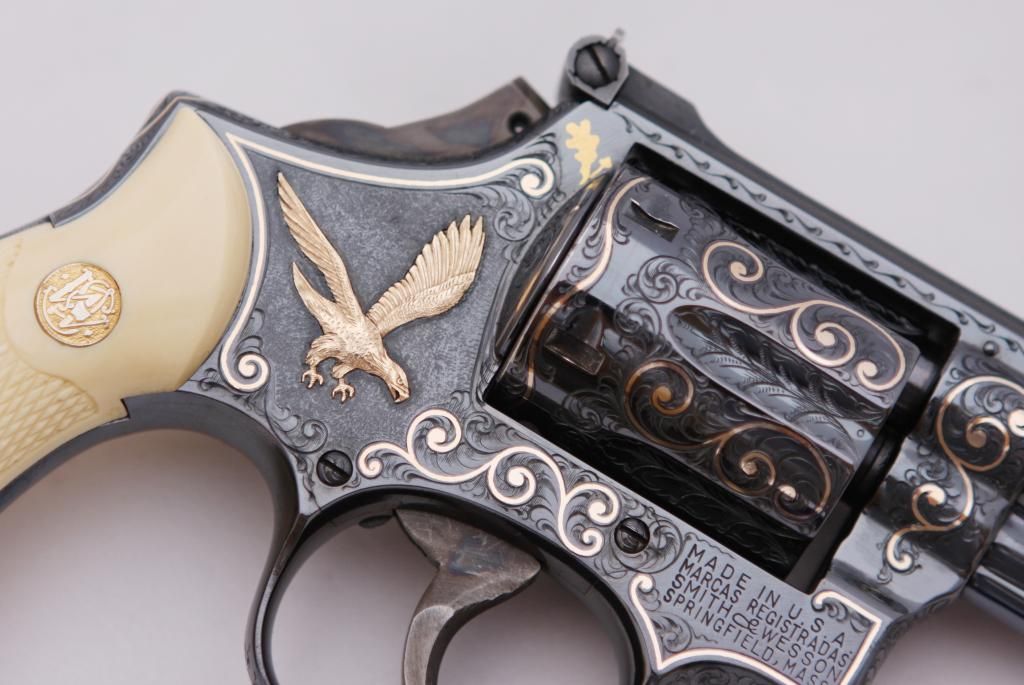

I now have two S&Ws with bobbed hammers. The other is one of the earliest 3" RB Combat Magnums (SN K500000) - sent to Walter Walsh and later engraved by Alvin White (I believe that you are familiar with this gun...;))
Larry:
It was a total surprise when I removed the grips. And a fun one at that, as it makes it a unique entry in my collection of 357 Magnums.:D
Wow, that's the kind of surprises I like! Mine are usually the "take off the grips and finding NO mainspring"!:eek::rolleyes: Just kidding, of course, I will NEVER complain about my luck.:)
Larry
It looks to me like they were having a fire sale on gold when White did that gun!
Either that, or his motto is, "Some's good, more's better, and too much is just right!!"----which is usually reserved for horsepower or money!
Ralph Tremaine

That U spring is pretty cool. This is the first time I have ever seen one or even heard of one. I've seen the W spring before, and it just seems overly complicated to manufacture.
I wonder why they didn't continue using the U spring once it was tried and found to work. It eliminates one part (rebound spring) and looks like it should work just fine.
