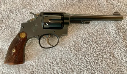

Seriously though, I looked through my meager collection and found most without any discernible gap. When backlit with a white backing 2 have a small gap that would be hard to see in any other way.
Unless I could see it under normal circumstances I wouldn’t worry about it. We sometimes look at things to closely and try and find flaws instead of just enjoying them for what they are, handmade objects that we like.
Buy revolvers like this and the problem is solved. 😎View attachment 818562
Very nice!
