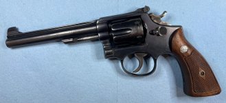

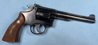

Some green pieces of paper changed hands, some paperwork was filled out, and this little beauty came home with me.
She's an early K-series serial number with a one line "Made in USA", so I'm thinking 1947-ish. I'll get an email out to Mike and Don shortly to start the letter process and find out for sure.
Edit - I'm off by a year here. See Jack's post down the thread.
All the serial numbers match except for the stocks, which are numbered to an earlier gun.

It has obviously been carried and used, but was well cared for. The finish appears to be original. From what I understand, she spent most (if not all) of her life in New Mexico.
The front sight pin is still proud and the rear sight has had the square edges tastefully rounded. There are no factory return stamps. The chambers have just a bit of buildup that needs to be scrubbed out, but the bore looks pristine.
