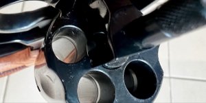

Last year I purchased online a new S&W 10-14. The double action was very rough, so I returned to S&W unfired. Two months later S&W replaced the entire revolver. The replacement was perfect in every way, in fact equal or superior to the many older Model 10 HB I have owned and shot in the past decades. Shoots to the sights out to 50 yards, quite accurate. After several hundred rounds it's proven to be excellent in every way.
So I figured it was time to try a new Model 36-10, despite having a peck of older I & J frames. These are rather difficult to find, with S&W selling mostly aluminium and scandium frame guns. Ordered one online from a well-known reputable wholesaler, and picked it up today. From all appearances, packaging, and lack of firing evidence, it appears NIB.
Well it looks like past is prologue. The barrel end at the forcing cone looks like it was cut with crooked hacksaw, which thereafter started chewing up on the cylinder face.
Yes, it's going back to the factory.

Well that looks downright horrendous. How something that cosmetically screwed leaves the factory boggles the mind.
I also still can't get over how bad the J-frame reshape to accommodate the frame-mounted firing pin and internal lock looks compared to the older models.
Just look at that angle near the hammer and compare the two!
Sorry to say this here on SWF, but I am absolutely convinced that a person can no longer "order" a new S&W. The QC is just too flaky. I've picked up two J's later over-the-counter. Both are near perfect mechanically, although I did find a small dent/gouge just above the sideplate on the 637. I notice it every time I pick it up, but I bought it to carry and shoot anyway so machts nichts ...

I called S&W Customer Service today. Even that has changed. Before an RMA would be issued, the rep wanted pics of the defects emailed to the S&W "QA" mailbox, so a supervisor could evaluate the defect first. After that evaluation, I will be contacted with a response.
