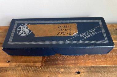

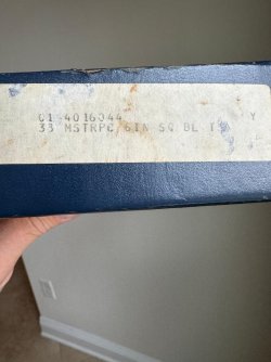

Purchased a very nice K-38 Masterpiece (5K56474) recently and it came in a tattered blue box with the white label pictured below
I take it that since my serial number doesn't appear on the box, this is not the proper factory box that this revolver shipped in?
Is the number "4016044" on the label a SKU number for this model?

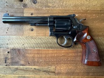

And a little off-topic, but would this pistol have shipped with the target stocks that are on it or with Magna's numbered to the gun?

That label was generally used when a revolver was shipped back to an owner from the factory for a repair.

Perhaps that's why the top of the box has two dates written on a piece of tape; maybe the pistol was received by S&W for repairs on 2/9/91 and the work was completed on 2/24/91?

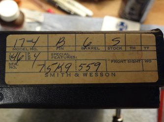

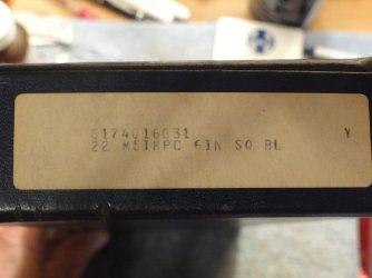

The remaining label on your box was on it when it left the factory the first time. Your box is missing the label containing the model, serial number, etc. Here are the labels from my Model 17-4 that I purchased new way back in April of 1980. The label like yours is still attached to the box, the other label has fallen off the box, but I still have it.
Notice the difference between your remaining label and mine. Yours has the letter "T" at the end of the second line, indicating "T"arget stocks. Mine does not have a letter there, indicating standard (or magna) stocks. Mine is a "22 Masterpiece, 6 inch barrel, square butt, blue finish". Yours is a "38 Masterpiece, 6 inch barrel, square butt, blue finish, target stocks". If you had the other label, it would have been marked with a T in the box labeled "STOCK". Yours would also have had a check mark in the boxes labeled "TH" and "TT" (for Target Hammer and Target Trigger). What the top line means I have no idea. Perhaps an inventory number at the S&W factory.
The stocks on your gun are quite likely the ones that were on it when it shipped. What the dates on the tape mean is anybody's guess.
