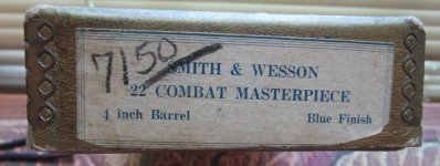

A few years ago I stumbled upon a .38 Combat Masterpiece at a local gun show in a 6" K-38 Masterpiece gold box, complete with a block of wood to make up the space. The SCSW confirmed that S&W had some extra gold 6" boxes and shipped 4" revolvers in them.
Last week I spotted a .22 Combat Masterpiece, a pre-Model 18 at another gun show. Thinking that it would be a good safe-mate to the .38, I bought it. The seller handed me it's serial-numbered box; not again! This time a blue box with another add-on sticker stating 4".
What are the chances?

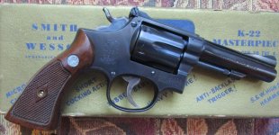

Here's the kne I have. Shipped in 1953.
This K-22 Combat Masterpiece came in this Masterpiece box (6") with the end label on one side with the CM serial number on the bottom.
March 24, 1952.

My combat masterpieces both came new in 6" masterpiece boxes with a Combat Masterpiece label on the end.
