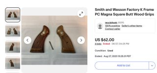

These recently sold on ebay. They have silver colored washers and probably date from 1973 to the early 1980's. Shipping was an additional $7.50 and ebay tacked on your State sales tax.
