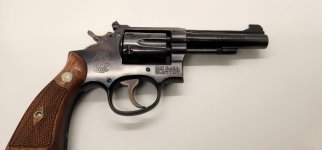

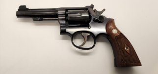

K32 shipped March 4th 1949
My K32 Masterpiece was shipped on March 4th, 1949. This must have been pretty early on.
Gil,
In case you're not aware Your Revolver may be a bit scarcer than what you may think!! Reason being...Given it has a 4-Inch Barrel....I believe it could be considered...For lack of a better way to describe it...A Pre-K32 Combat Masterpiece of which I'm fairly certain were never ever produced with a Model Number assigned to them!!
If so...From what I gather there were only 10 with a 4-Inch Barrel built!! If I'm wrong I'm sure someone will be along shortly to let me know if I've given you incorrect information!!

Yes this was one of the 10 that were shipped with a 4" barrel.
Per the letter:
The K-32 Masterpiece (Model 16) was continued in production until June of 1973 when the demand was so small that it was officially discontinued, with only 3,630 revolvers being produced over the twenty-six years it was produced, thus making it the rarest of the standard K Masterpiece series.
We have researched your Smith & Wesson K.32 Masterpiece Pre-Model 16. Five Screw Variation, caliber .32 S& W Long, revolver in company records which indicate that your handgun, with serial number K67160 was shipped from our factory on, March 4, 1949 , and delivered to B. W. Folsom, Warren, OH. This revolver was shipped with a 4 inch barrel equipped with a Partridge front sight, blue finish, and checkered walnut grips. This was a special order for 10 units with the 4 inch barrels and there was an extra charge of $6.00 for cutting the barrels and
fitting them.
