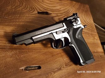

I was able to remove the barrel weight off of my 6 inch 9mm Target Champion after translating the removal instructions from German. I also re secured the briley bushing system following the thread by BMCM. (Thanks btw)
Now becoming familiar with the barrel weight disassembly and re securing the bushing system I'm ready for some serious shooting. The polygonal Lothar Walther 6” barrel is a piece of art within itself. I wish I could source the original 5inch barrel so I could swap back and forth but I'm sure it's long lost somewhere in Germany.

There's a tiny set screw front of the dust cover on the bottom on the barrel weight that has to be removed before disassembly. (Mine is actually missing) It can seem intimidating at first but it's incredibly simple. Be careful not to lose the tiny alignment wedge. And yes I used the 90° snap ring pliers to remove the castle like nut. It was not tight. It just snugs up and it's held in place with the internal wedge and set screw on the bottom.
Here's the full instructions translated.
When assembling the barrel weight, care must be taken to ensure that this is done with the weapon completely assembled
Screw the round nut (2) onto the barrel until it stops. Then turn the round nut back until the red mark on the round nut lines up with the recess
Insert wedge (3) (red marking on wedge to red marking on round nut
Slide on the Lawi weight (1).
-Insert intermediate washer (4).
Insert O-ring (5).
Screw on the round nut (6) until the red marking in the round nut matches the red marking in the barrel weight
Screw in the locking screw (7).
page 2 ******
Dismantling
Locking screw (7)
Unscrew the round nut (6) using the key supplied
Remove the running weight (1). Remove the castor (3).
Unscrew edge nut (2).
Further disassembly as in the original manual
