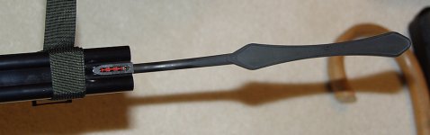

First of all, cool rifle. Had to laugh when I saw the photo . . . imagined mounting two MagnetoSpeeds with long, overlapping velcro straps lol.
I actually did mount the magnetospeed on the double.
I used a piece of power cord to fill the space between the barrels.
When the tech saw my pix he laughed and told me no way it would work.
It wasn't very stable anyway.
