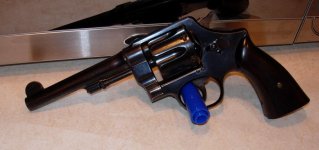

I attached the pic of my 1917. It is a "parts" gun from what I can find. The barrel was replaced by a "non" S&W gunsmith, no serial number on it, but does have the "United States Property" stamp. The finish on the barrel does not match the frame. The cylinder is not original, neither are the grips. The crane is original. Action is near perfect and overall the gun is in great shape for it's age. Manufactured December 1917, S/N 5740. The hammer has the original "curved groove" effect and the lanyard ring is not missing.

I presume the SN on the cylinder doesn't match the butt number.
The replacement barrel was probably installed by a military armorer. Or it could have been a military surplus barrel.

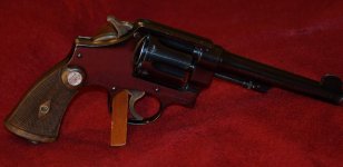

Picked this one up a few weeks ago. Was interested in it for the pre WWII Magna stocks that were on it, needed them for a .38/44 OD that I have.
I believe it's a S&W 1917 Commercial chambered in .45ACP. I say believe because it's in no way original. The barrel has been cut down to 3.5". The serial number on the cylinder, extractor, and barrel are removed. The serial on on the crane is not matching. The serial on the frame is 624XX, which is way earlier than the Commercials were supposedly being built. It was missing the lanyard ring but I was able to locate one and make a retaining pin to hold it in place. This is an example of a gun that is so wrong, that it just works.
I had to completely disassemble the gun, clean it, and reassemble properly to get it to work. It could not be cocked into single action and the double action trigger was approximately 2768 pounds. Now, the trigger is a dream in both single action and double.
Only issue left to deal with is the front sight is soldered on leaning slightly to the left. This causes the gun to shoot slightly high and to the right.
So I'm wondering if it's actually a 1917 Commercial frame or if it's a 2nd Model Hand Ejector, or maybe something else completely different. Anyone got an idea on what the frame actually is? It doesn't have the "Made in USA" mark on it, which leads me to think pre 1921.
A couple of thoughts.
The Magna stocks are post WW II; the checkering has rounded corners instead of the pre war sharp corners and the medallion are the smaller post war curved nickel plated instead of the pre war 1/2" flat silver.
On pre war and early post war hand ejectors, the yoke does not have the serial # on it, only the factory assembly number.
The only other frame prior to the "Made In USA" stamped frames (which was ordered June 1922) that could have a 624XX serial number is a 455 HE, 2nd Model. The 1917 Army did not have a S&W logo on the frame. I think I see one on the left side of your frame, if not it's a 1917. Although the 455s did have the logo, it's larger and on the sideplate.

Right. The serial # is not the same.

Yes, I indicated that this gun was bought for the stocks and used on my .38/44 OD. These are the stocks that I swapped them for. You can see what was on them below.
This is the conundrum with the frame. It's to early for a commercial 1917 and the S&W doesn't match for a second model. Can't figure out any option that makes sense.
bwdilli,
Since the back of the cylinder has no serial and appears to me to have been shaved, the logical assumption was that it started out as a .455 and converted to .45 Colt or .45 Auto Rim. I'm not clear about which of the fitter's numbers are the same on your gun but if all the major parts started out together, the same number should be on the crane, the frame and inside the side plate. The same serial number (different from the fitter's number) should be on the rear facing face of the crane and the front face of the ejector star. Those are both difficult to see but by disassembly or use of a bright light and magnifier, they should be seen by looking through the chambers. My most likely scenario is that it started out as a .455 Second that had its cylinder converted to .45 and a modified .45 barrel installed. But I am stumped by the small logo on the left. If there is a tiny eagle head and S# anywhere on the frame, it would indicate that it was a left over govt. inspected frame.
Nothing but guesses without a close inspection in hand.
In any event, when the front sight is corrected, I think that it is a very attractive and useful carry gun.
