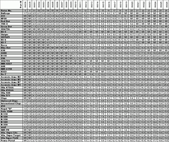

Found eleven RCBS Little Dandy Pistol Powder Measure Rotors. What are they and are they worth anything. I believe all are new in box and each has a number applied to it. I assume each number is for a different powder charge.
I have one of the powder measures and several drums that were my dads but have never used it. You’re correct that each drum throws a specific volume of powder but the weight thrown depends on the specific powder. I’m not sure if I have it or just saw a chart that gives the charge thrown for each drum and powder. Best thing since some powders have changed over time like Nitro100NF is to throw charges with various drums with the powder you use and do your own chart of weights. As to any value, probably no real value. I’ve never known of anyone that used them and I’ve never seen one other than the one I have. I don’t think my dad used it much either. But the way people are today there might be a cult following and people paying a hundred dollars for each drum. I’d just do a search and see what I found. Try eBay and see if any have sold.

The Chart is only good for older powders. Just verify what it is throwing before you start

The charts that RCBS provides give a close approximation of the charge they will drop, but once the dropped charge has been accurately weighed one can count on the next one being the same as well as all the rest that follow. Note however that when the powder reservoir gets very low, the charges dropped may become noticeably lighter. Just as a comparison, I have used mine to load for a bench rest match just to see if it worked. I didn’t win, but I was competitive! :cool:

I have four set up all the time, I only use for pistol/revolver and never needed a rotor above #9. there was a guy making adjustable rotors but never tried one. You can find the most recent rotor chart on RCBS site

My Little Dandy is all I ever use for handgun loads. As mentioned though the chart will get you in the right zip code, but a scale is mandatory.

I found that the RCBS chart is very conservative so I made my own for Unique and Red Dot. Winters are long and dark. 😁
