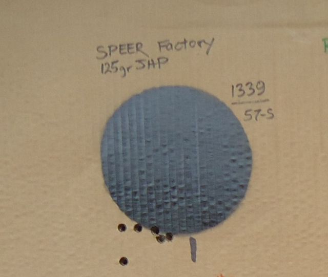

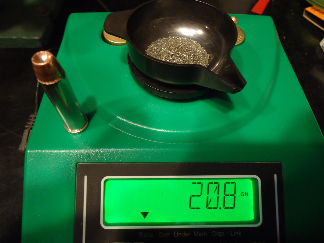

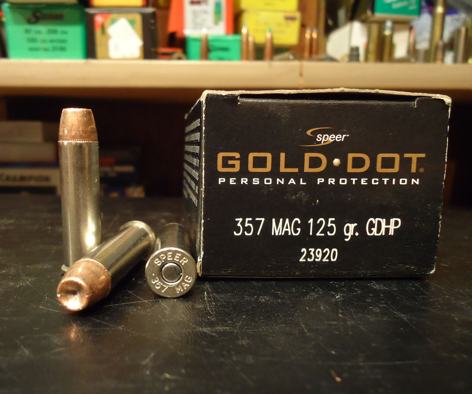

A few years before I standardized this method I looked at the Gold Dot 125gr factory load;
https://i.postimg.cc/yYRNKpxB/Speer125-GD.jpg
https://i.postimg.cc/TYDz1Zn7/Speer20-8grs.jpg
https://i.postimg.cc/1XQDkh2q/Speer-GD-125gr.jpg
So, we see that Win, Rem, and Fed ammo is loaded with 19.5-19.8 grs of a non-canister ball powder.
The Gold Dot load contains 20.8grs of ball powder.
