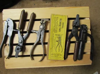

I started reloading .30-06 when I was about 14 or 15. I bought the Lyman 310 tool from Gander Mountain. I got my middle sister's husband to get me powder bullets and primers. I did 75 the first time and fired them all in one range session. (Yes, my arm was sore). I later moved up to an RCBS Junior press then about 25 years ago a Dillon 550B because I started shooting a lot more pistol. It was .44-04 for Cowboy Action and I could not always find cowboy ammo and when I would reload with the RCBS it took too long for the quantity. I also have some antique reloading tools that I have used for Black Power reloading. These are what is in the picture. First two on the left are Winchester for .44WCF. The Nickel tool and the yellow box are for .38WCF and .32 S&W Long (in box). The two tools on the right are Winchester for .38-55. Not shown is a similar tool like the right tools from Winchester in .45-70. I have used all except the .32 S&W Long because I do not have a gun that fires that cartridge.

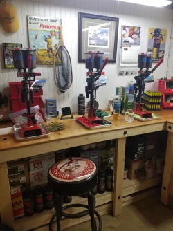

I have 4 MEC Sizemasters - one in 12, 16, 20, and 28. I love them and wouldn't want any automation involved.
I also have an RCBS RockChucker. When it comes to rifle handloading, I load for precision for a specific chamber. Every step is checked and deliberate.
In all the loading I've done - knock on wood - I've never once had a problem. And I've learned a ton in the process that I suspect I might not have had I depended on an automated system.

I started in 1973 with a Lyman 310 Tool for 38/357 and 45 ACP. Progresses to a Lyman Spar-T turret press. Then to a Dillion Square Deal B, until I broke it (yes, you read that right I broke the frame). After Dillion replaced it, I went to a bigger version of the Lyman Turret Press and that is where I am today. Hate the Lee Loader, have seen to many primers set off with one of those.....
I used a LEE Priming Tool which I think I still have.
